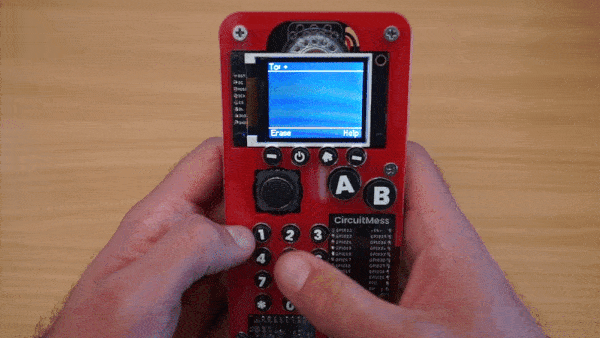

Each button represents a set of different characters and functions. It’s all located in an array. When you press the button once, it prints out the first character in that array.
If you press it again within a small time interval (approx. 500ms), it will change that character to the second one in that array and so on.
When it comes to the last position in the array and you again press the same button, it returns the very first character in that array.
That means that the character selection is cyclic.
If you don’t press the same button fast enough, the selected character will be permanently written and you will begin a new character selection, again starting from the first one in the array.
If you press any other button within any time interval, it will immediately print out the currently selected character (assuming that you are in a different button’s array).
Then it will start a selection in its own array and you will again be able to switch between the characters by fast pressing that exact same button.

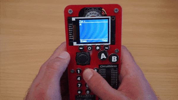

One more important function of the buttons is the long press.
If you hold down any number between 1 and 9 a little bit longer (approx. one second), a number will immediately appear and you won’t enter the character array selection.
If you hold the number 0, a ‘+’ sign will appear instead.

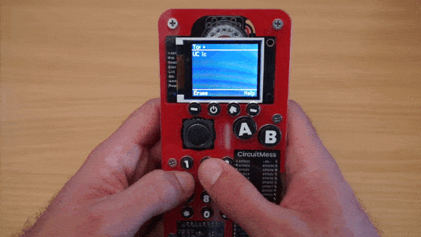

Pressing the # button once will make all the letters in the future appear in UPPER CASE. Pressing the same button once again will start writing letters back in lower case.

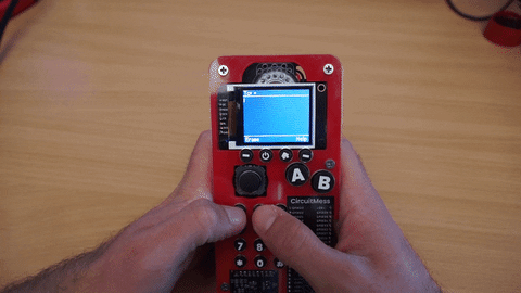

The * button serves as a SPACE and it will leave one blank space after every press.

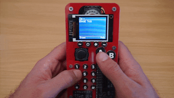

Erasing a character is done with the LEFT FUNCTION BUTTON, the most left one out of four
buttons right below the screen.

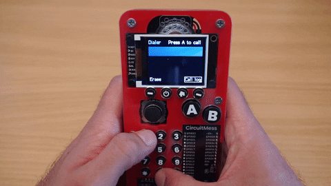

When you are in the numbers writing section (ex. entering a phone number), all of the number buttons will immediately write out a number they are assigned to.
